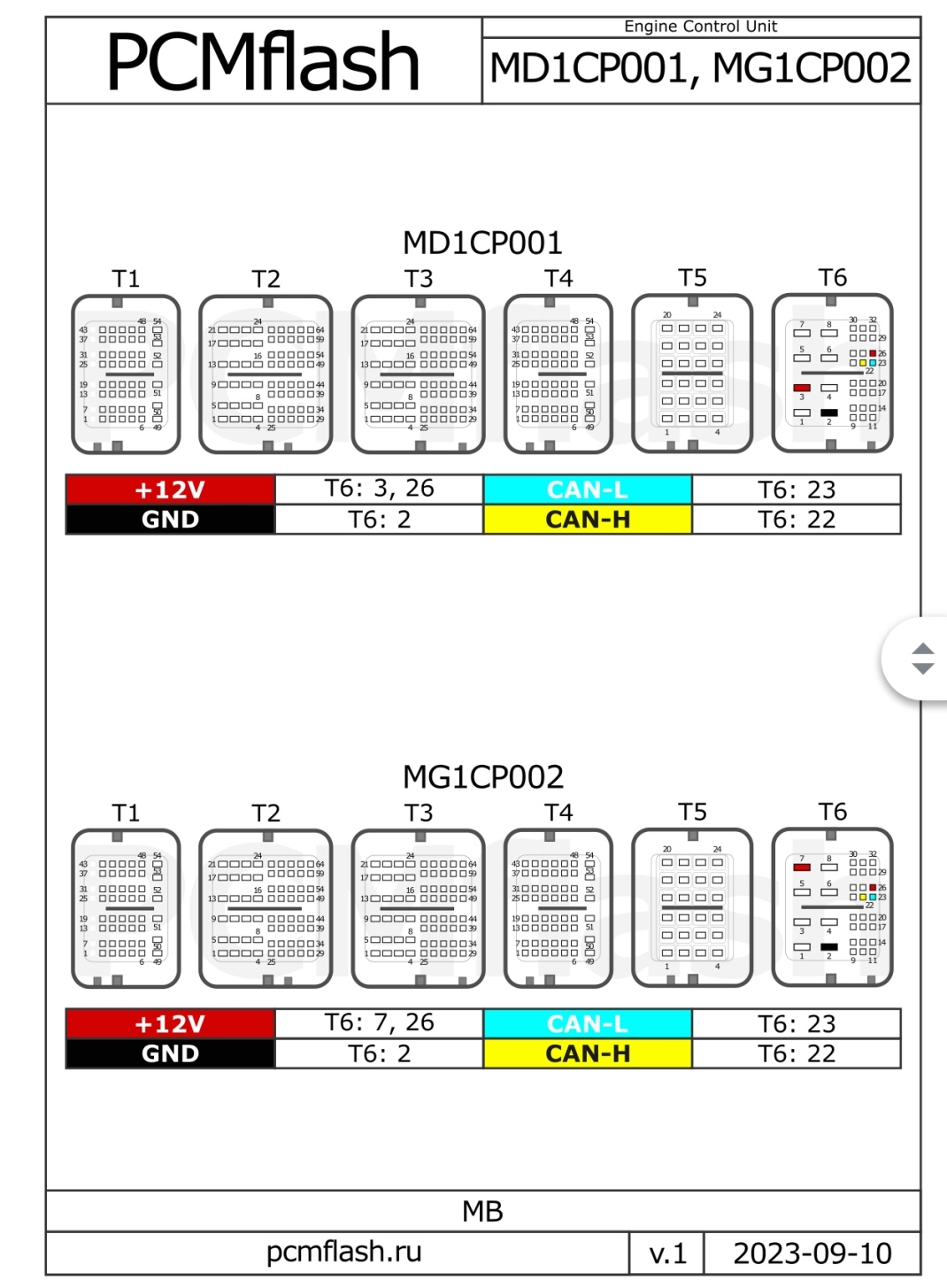

Privet vsem, mne sivodnja 4ilawek sprosil :
Mercedes 2016 Eklass 220 CDI stage 1 i imu nushna Udalit ashipku Nox sensor okay..
tiper ja na4inaju smotret i wishu shto tam moshet stojat takoj ecu MD1CP001
ktota evo ushe delal, pcmflasher SM2 Pro Otlom Wasmot?? kakoj Modul??
